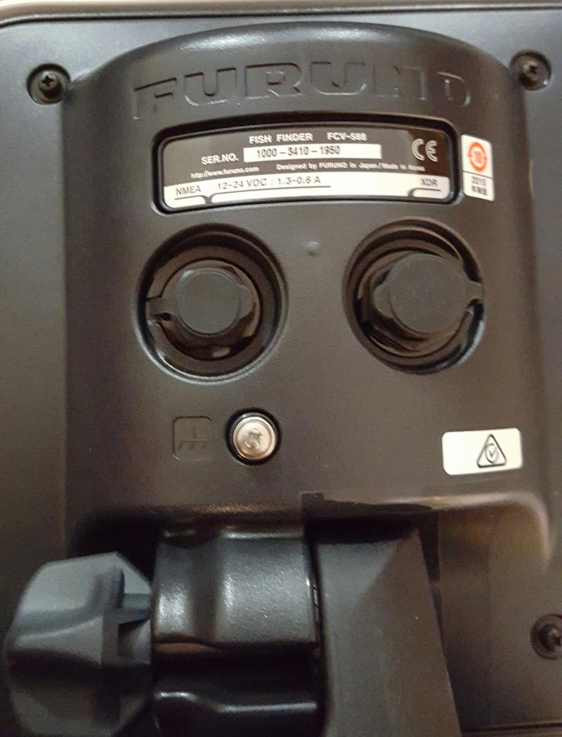

The 588 sounder finally arrive and would like to give the install a crack. If Im just intending to use it as a stand alone sounder and not  network it is it just a matter of:
1. taking the red and blacked wires (fused) and taking them to the boats fuse board and leaving the other 8 wires out?
2. Whats the go with the ground wire at the back of the unit? Is this needed  as it is earthed already with the black wire.
Any help appreciated!

 2. Is the second photo i.e.
Sat, 2016-04-30 10:42
 2. Is the second photo i.e. the screw at the back of the sounder for connecting an o terminal fitting

Just go with the red and black it is all you will need
if you have a plotter on board it is definately worth connecting up the nmea wires so you can mark fish edges on the sounder

 What Tim said. Dont worry
Sat, 2016-04-30 11:56
 What Tim said. Dont worry about grounding or that screw on the back.

 Red to positive and black to
Sat, 2016-04-30 12:57
 Red to positive and black to negative and your all done

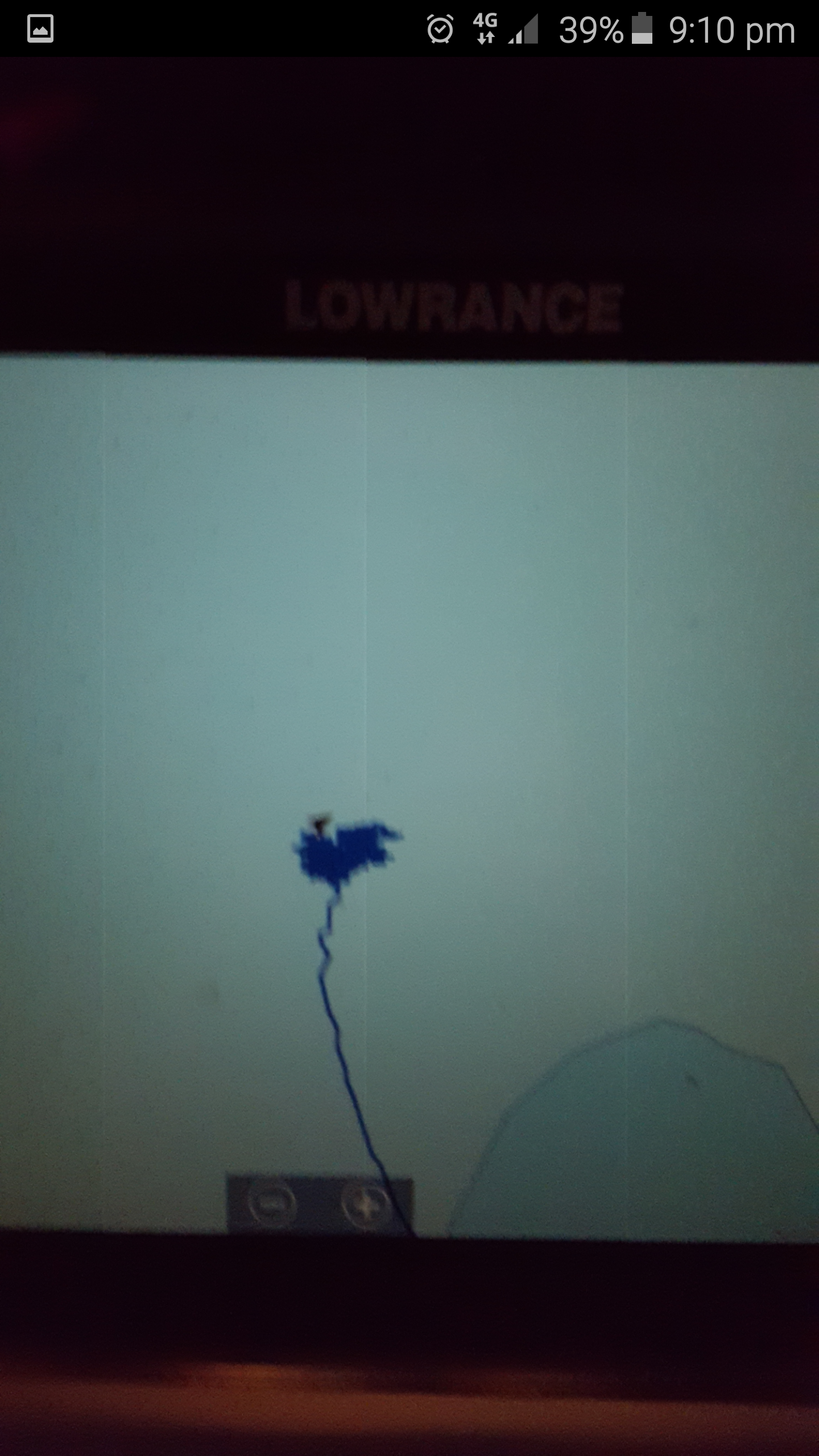

Im going to network it together. I Installed a motorguide eleccy that I tested on the weekend (added phot) and have yet to get the gateway kit to link to the sounder i.e. mark a school and then hit spot lock anchor. The scroll back function on the lowrance is awesome and you can mark it on the map and autopilot back. When I do that will wire the furuno in so I can use the lowrance for charts, autopilot with the eleccy and structure scan and then use the furuno as a dedicated sounder.
Impressed with the eleccy.. on weekend held a spot in 15knot winds. Last photo is 2.5 hours on the same spot zoomed in as far as plotter goes
