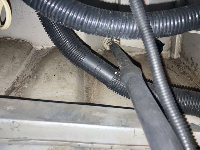

 Hi all,
I've recently bought a boat, and am a little concerned at the hose that connects the skin fitting to the kill tank.  It looks like it's normal garden poly pipe (3/4"), which kinks easily, and can split at the kink if you're not careful.  It's the one running from the camera all the way to the back of the boat in the attached picture.
As this is below the waterline, I'm concerned about it.
I bought some radiator hose (thick rubber, reinforced with string) however it seems like it's a little too thick to get through the passageway underneath the fuel tank.
What hose would you recommend for this application?

 I would use a wire reinforced clear hose. I think it's commonly called suction hose.

 And double hose clamps on
Tue, 2020-12-15 12:29
 And double hose clamps on anything under water line.

Plastic
Tue, 2020-12-15 12:38
 That skin fitting looks like plastic. If it is I would swap it for a metal one.

 Jesus, that's pretty average and looks like it's kinked ready to split. I've literally just put a skin fitting in mine 316 stainless and reinforced clear hose, also a ball valve attached to skin fitting so I can shut it off if anything happens with the hose.

 While I agree it looks a bit shit and the clear hose would be a far better option, there is no reason you can't use that retic hose. It will handle water pressure far above what it's being used for.

Feral, the picture might not be very clear, but the hose has a couple of permanent kinks in it, which are just asking to split and dump my family into the ocean.  Not ideal.
I agree that new poly pipe can handle a lot of pressure, but I doubt it's rated for below waterline applciations, especially when it's old and kinked!
