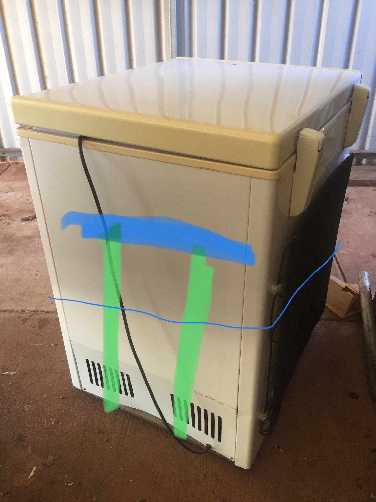

I know lots of us take deep freezers on the longer trips away but how does everyone lift them when full?
im thinking of going to the local canvas shop and getting some straps stitched together to run underneath the freezer with some handles attached I’ll them run a ratchet strap around the freezer to hopefully keep the straps in place, any other ideas?
dodgy photo attached

 I just use one or sometimes two ratchet  straps. Good for about 150 kg

I just rivetted handles on.
Sun, 2018-05-13 07:37
 You know the folding type, cheap from Bunnings . I mean, if you are prepared to load it up and cart it around camping, it can't be too flash. Looks like yours is abit dented around the bottom anyway   Unless you are "camping" where you have full time 240v, you'll need to run a generator a lot. I got sick of that shit, and made my own, 12/240. 130 litres, works a treat, fan forced inside, will freeze fish down a lot quicker than a chest freezer.
And the handles I was talking about above are the type that is on this home-made one. Screw or pop-rivet to your home freezer, worked for us.

 Geez that’s a job looks good. I was originally going to just screw handles to the side but I did a quick google and found that lots of copper pipes run around a freezer so decided not too. Yep mines just a fishing freezer and does run of a geny.

yeah, you do need to be careful about screwing into the sides of freezers, as the refrigerant tubing  is running around in there--but they generally have it really close to the inner surface of the freezer, with the insulation on the outside, so, if you use the minimum length teks to get a bite (12mm?) you are pretty safe.

 we always just half empty, lift then refill. takes all of about 5 mins and not sure why you'd task the risk screwing into it?!

why not just strap a old fridge trolley to it .
