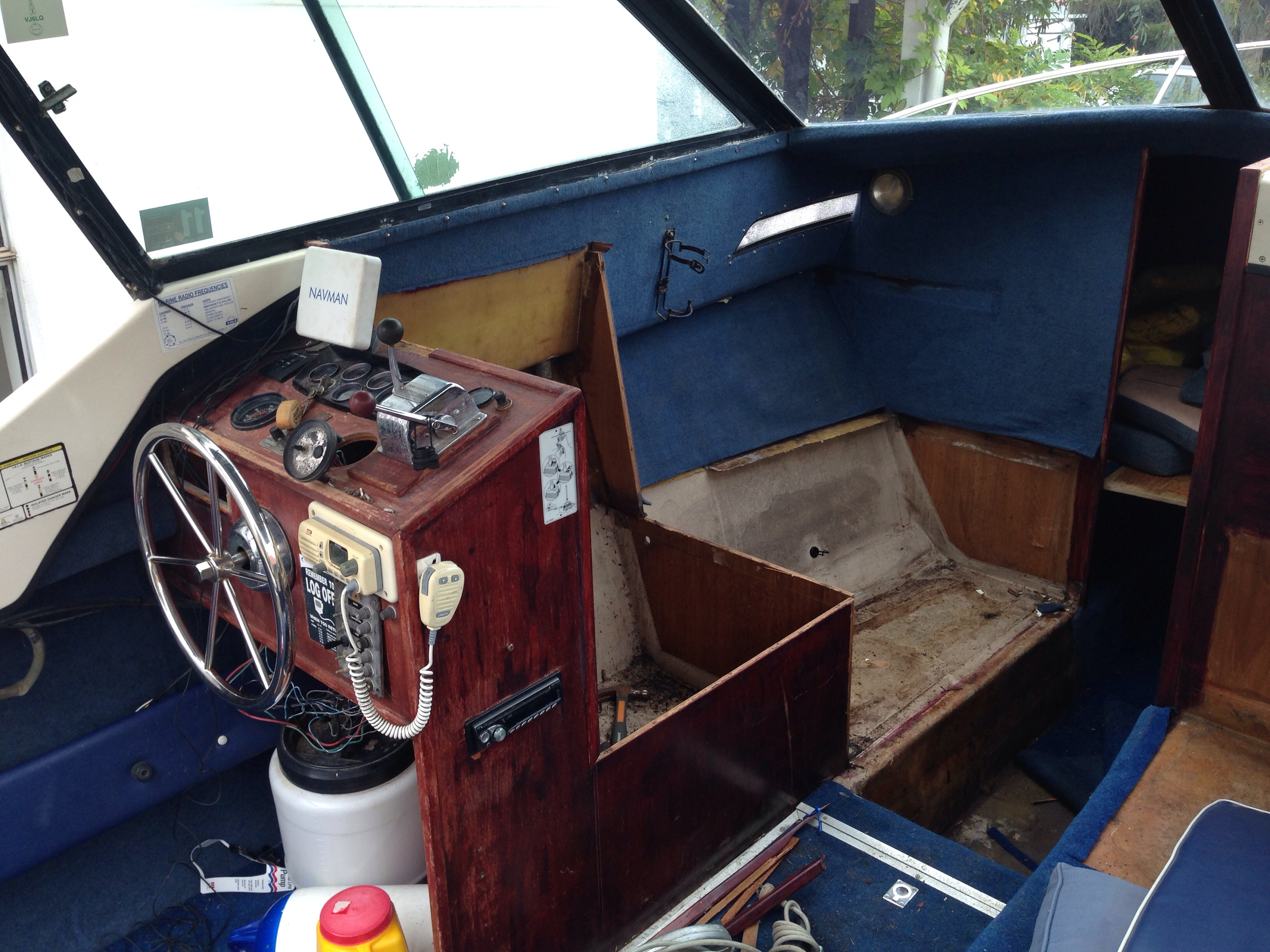

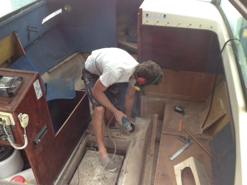

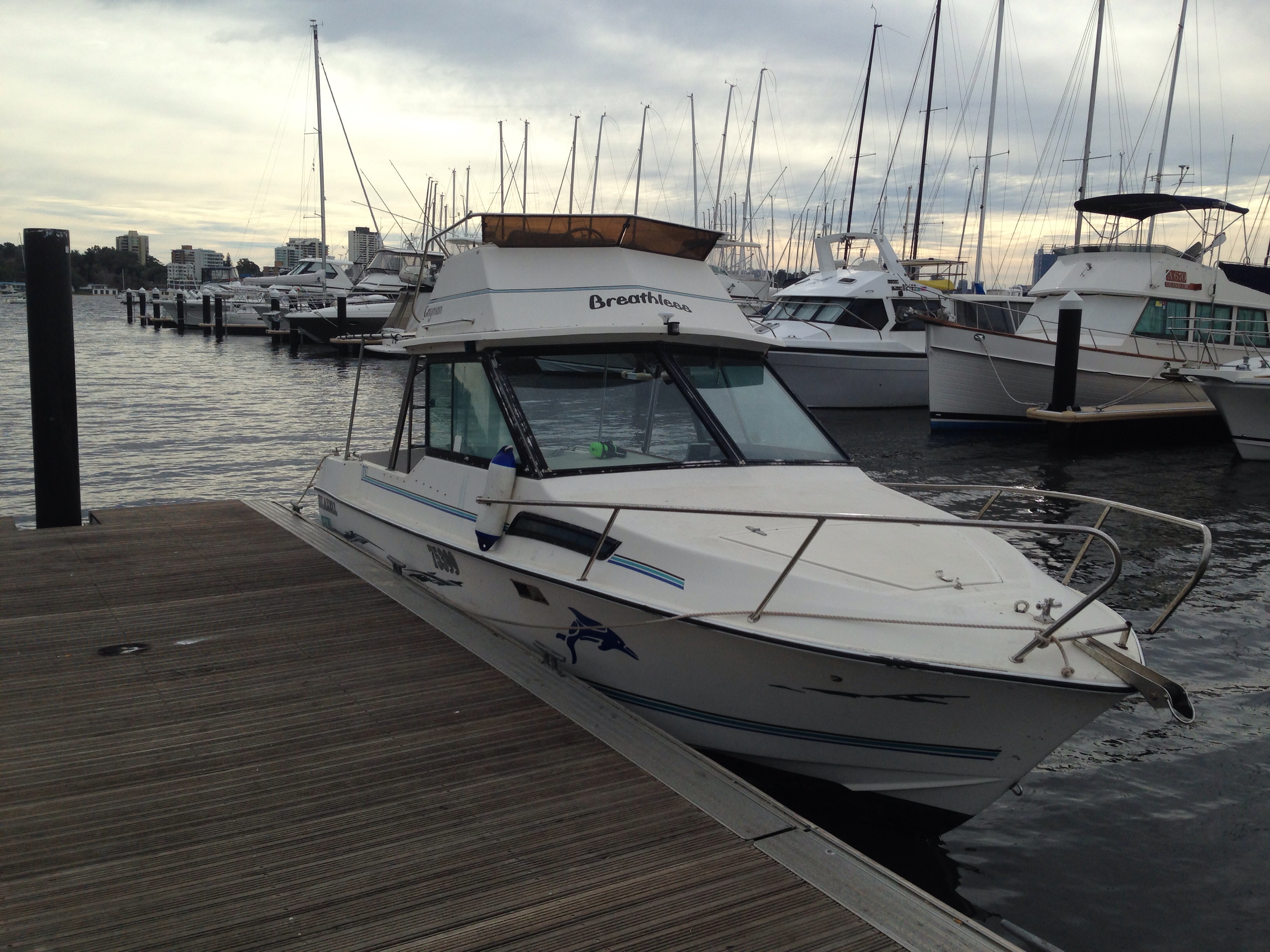

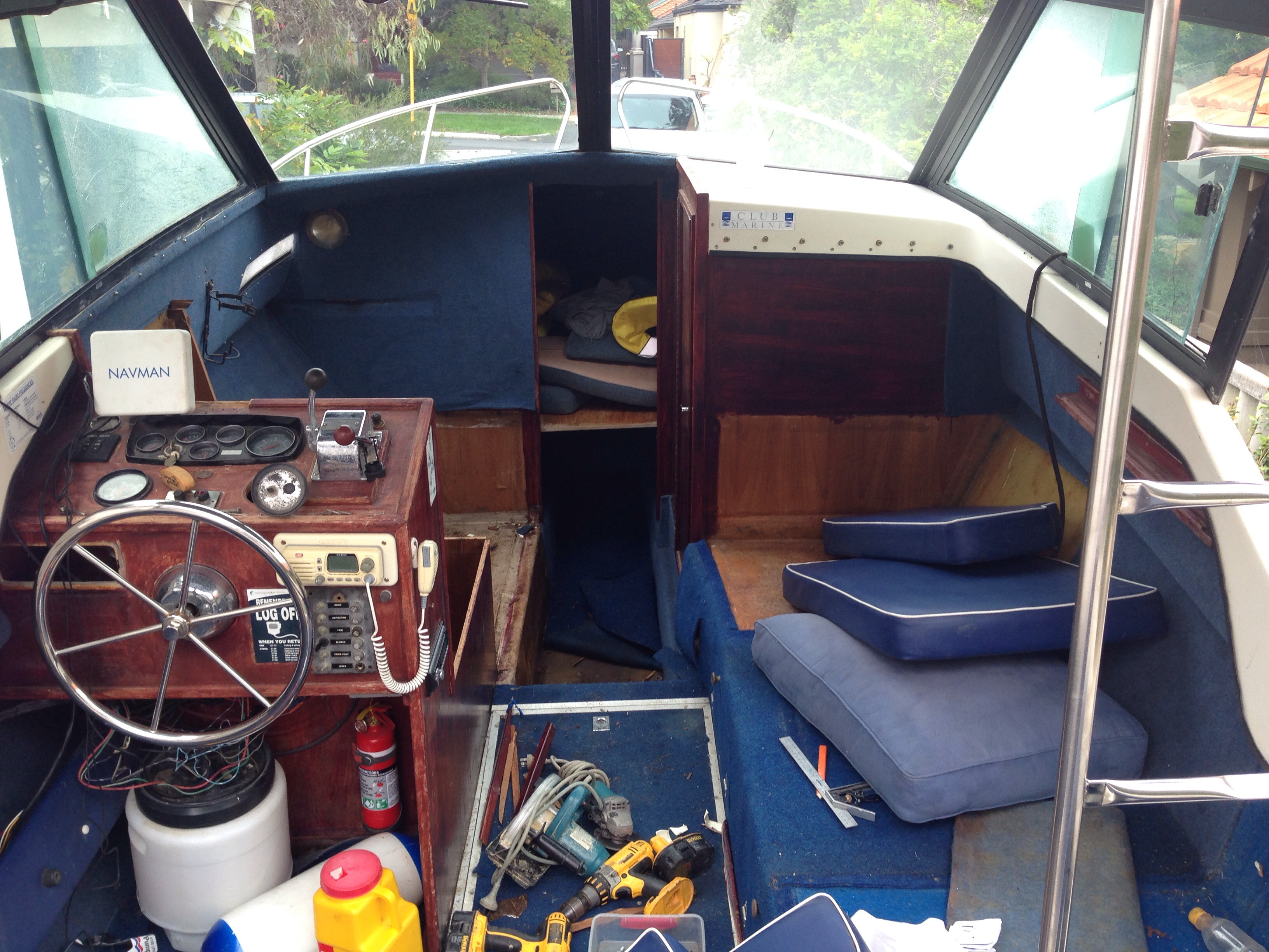

 Hi guys I have recently purchased a 24ft 80s Blaxell flybridge and am in the early stages of attempting my first nautical refit!
Im looking to move the drive console as it currently in an awkward position for my planned refit and I would like to get the whole tub professionally rewired in the process as it is an absolute mess at the moment!
does anyone know what it is worth to get an auto elec to rewire a whole boat?
And how hard/expensive is it to extend/replace the hydraulics for the steering, throttle and gear shift?

 are those controls hydraulic
Sun, 2014-06-08 15:45
 are those controls hydraulic or morse cable?
Given the age of the boat I wouldnt be suprised if the hydraulic lines are copper, not to hard to extend.
Should be able to get the parts from any hydraulic shop (even Bunnings?) and its pretty easy to bend and route, just anneal the copper first. Fittings either flare or nut and ferrule.
Slightly unusual having the steering station on the port side, are you moving it to stb or just to another location on portside?
The reasoning for most being on stb side is that is the side where a standon vessel will be coming from that you need to avoid hence easier to see.
But if moving it running lines across the boat will be harder, and better option to start again from the stern.
You can also buy flex lines to use.

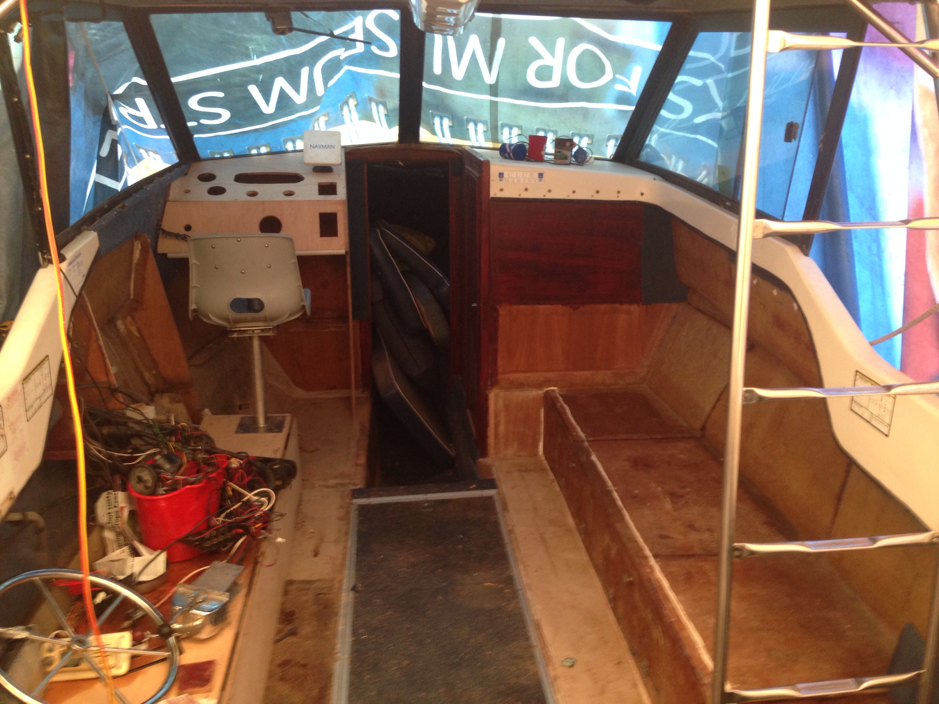

 Cheers guys the hydraulic
Sun, 2014-06-08 18:20
 Cheers guys the hydraulic lines are plastic (or whatever it is not copper) so can i join that or re run them? I just want to push the drive console up closer to the windscreen, hopefully it will make vis better but also allows space for bench seats for 3 people down each side, and a  collapsable table in the centre that will fold down to be a second double berth (accross the boat). If you guys are interested in this project ill be more than happy to post progress photos in exchange for advice!
 Lifes better fishin'
Posts: 5847
Its probably the
Sun, 2014-06-08 19:30
Its probably the Seastar/Baystar type hose. You can get joiners or just replace all the hoses?

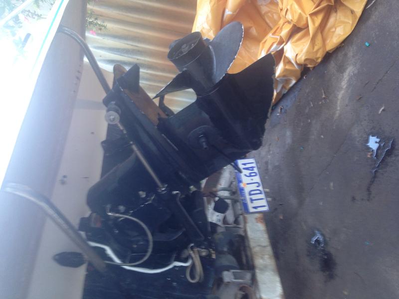

 whats it got for power?If
Mon, 2014-06-09 10:34
If its petrol sterndrive as Im guessing, then DONT skimp or bodge anything in the engine bay.
Good quality fuel fittings, intrinsically safe electrical equipment (not automotive starters etc), vent blower etc and get advice from an expert on this aspect if needed.
One litre of petrol in vapor=1 stick powergel is the formulae I was told while doing Advanced Shipboard Fire Control
Old engine room saying
Sun, 2014-06-08 20:38
One flash and you're ash, as Rob H said don't think about skimping on fittings in the engine room

 Cheers guys yeah i was itchy AF on sunday! Haha its a 5.7L volvo penta yeah the petrol, mercruiser manifolds and leg. So can anyone recomend a good auto elec to rewire her? I think im gonna keep the drive console on the port side because it works better with the layout, the vis is pretty good from there (or atleast it will be) and theres always the fly if you want more.. Which brings me too my next question- wheres the best place to get a couple of sheets of persex to cut some new windows?

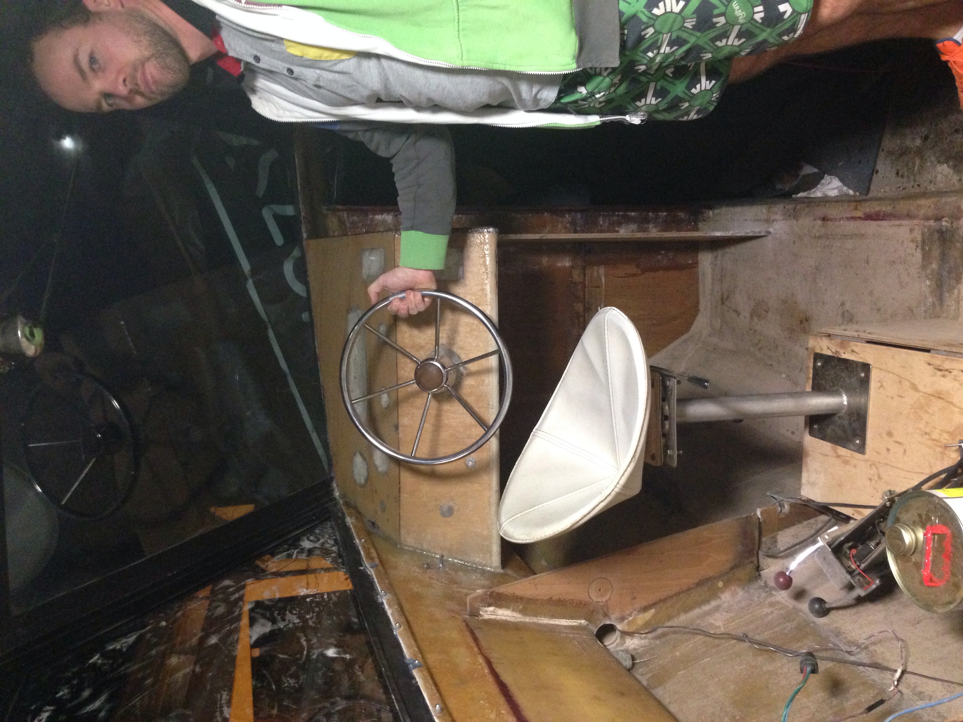

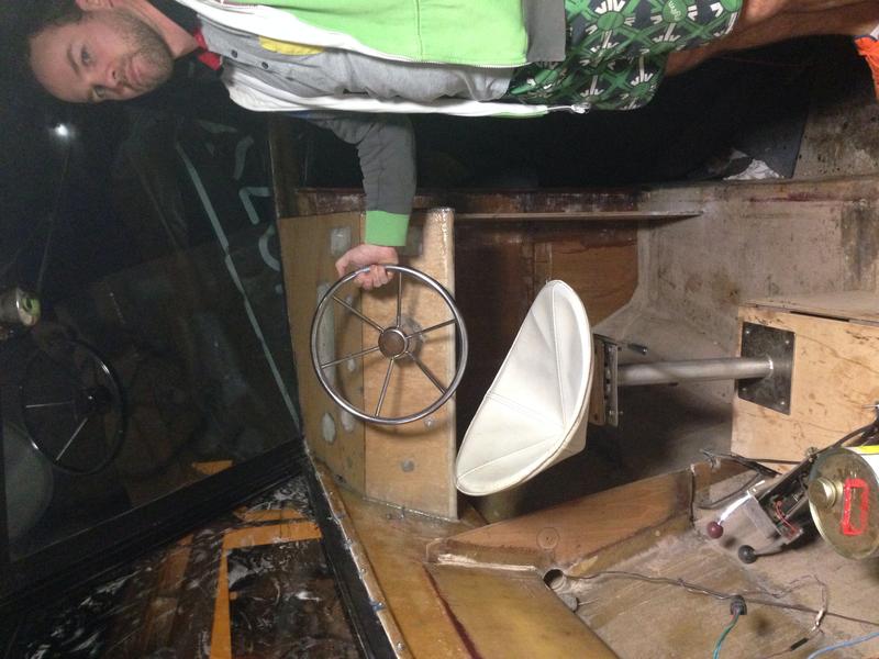

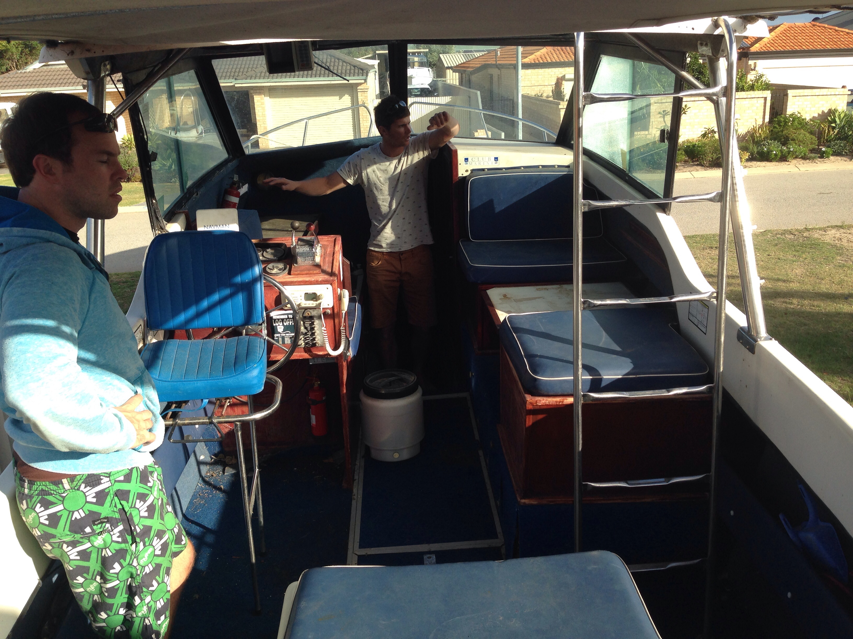

 Bit of an update guys we ve
Sun, 2014-08-10 22:31
 Bit of an update guys we ve been chipping away at it slowly but surely, done some work on the trailer including electric winch and rollers. Built the new drive console and have it glassed in, and working on our bench seat setup. The boat feels HUGE now with the new layout and we re pretty happy with how things are going.. We have the wiring setup under control having been through and deleted all the excess/dead/superceeded circuits and we re ready to hook it all up as soon as the console is finished! Plenty more to go and I feel like summer could sneak up quickly! But hopefully the fibreglass itch will be a distant memory by then and we ll see a few of you at rotto! As usual im open to any comments/hints/tips or cautions so please fire away!
oh and also the windows went back in today with new perspex and resprayed frames (forgot to get a pic but they look sweet!)

Hydatulic steering
Tue, 2014-09-09 20:10
 Hi guys dont think anyones reading this anymore but we are having an issue with the steering. We have extended the lines to a new console and bled the system but it still feels a bit stiff and doesnt turn smoothely.. Any bleeding tips or suggestions on what might be happening greatly appreciated!
